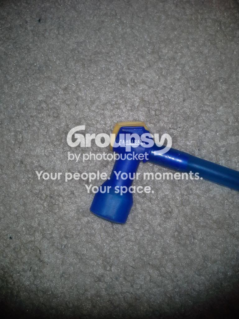

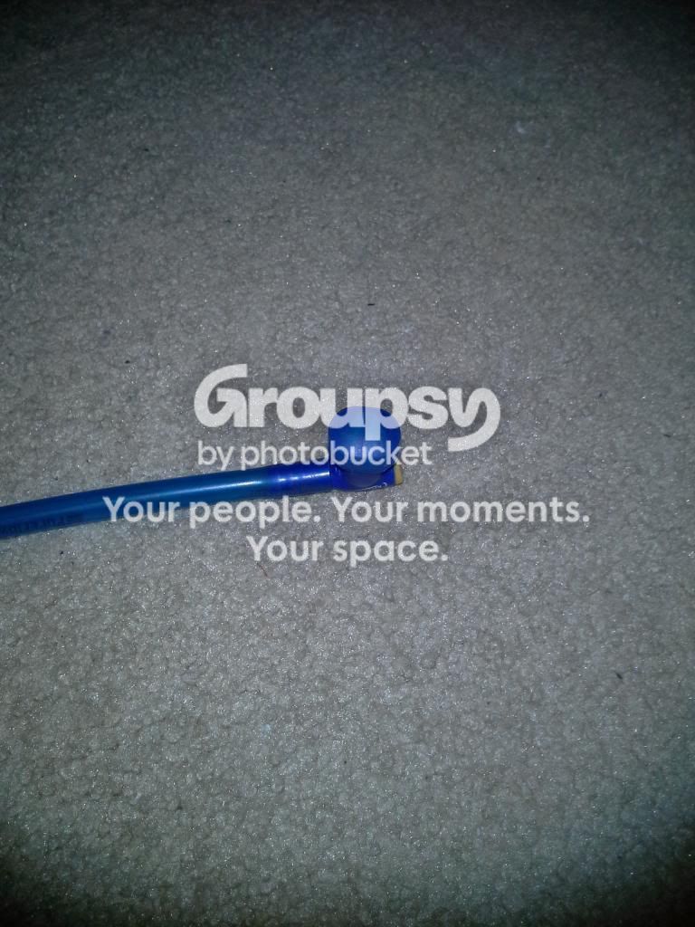

Hi! I hope you're still hanging around here.
Question about the CamelBak - what bite valve do you use? I am having FF helmet / bite valve compatibility issues, and would appreciate any help you can offer.
Thanks!
I won't do trips without a camelbak. Here's a picture of mine. I wear a full face helmet and have no problems with the bite valve. My helmet doesn't have a chin skirt.
blastoff
May 2, 2014
10
NW WA
Ok, I see you're using the standard bite valve.
Maybe I just need to be more clever, but I'm having some trouble with this. The chinbar on my Icon Airmada "wraps under" a little bit (but no skirt) and there just isn't room for *anything* to snake under there. Maybe I'll try going in from topside... but the shield on this helmet is well nigh unto impossible to open with one hand.
Or maybe I'll drill a hole... :eek:
