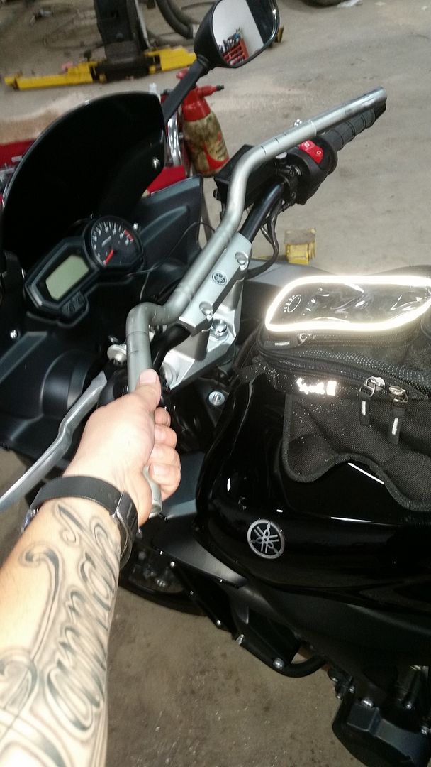

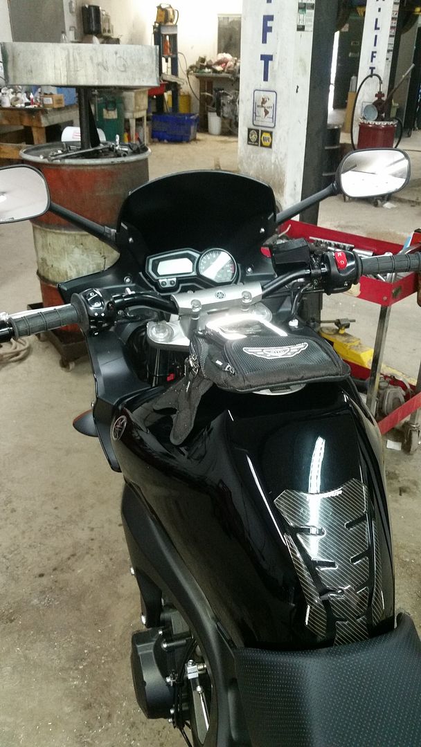

Hi all, I need to change the handlebars on my 09 fz6, the kill my wrists and elbows, Ive tried just riding this year to see if I can adapt to them , but no go.. So I'm looking for a straight bolt on no mod handlebar setup ( less sweep) . and a parts list of anything else I may need, like bar ends.. I'm not afraid to drill or anything. please help! I've read that any 7/8 bars will fit , to only fz1 will be proper, so I'm kind of confused. I'm kind of rural , so its 3 day wait for any parts from anywhere, so I'd like to be ready to swap over in an evening

Any 7/8" bars will work, but FZ6, FZ1, and FZ6R handlebars all use the same bar end weights.
FZ6R handlebars have less of a sweep angle, with the same amount of rise.
FZ1 handlebars have less of a sweep angle and no rise, so you're more leaned over.
