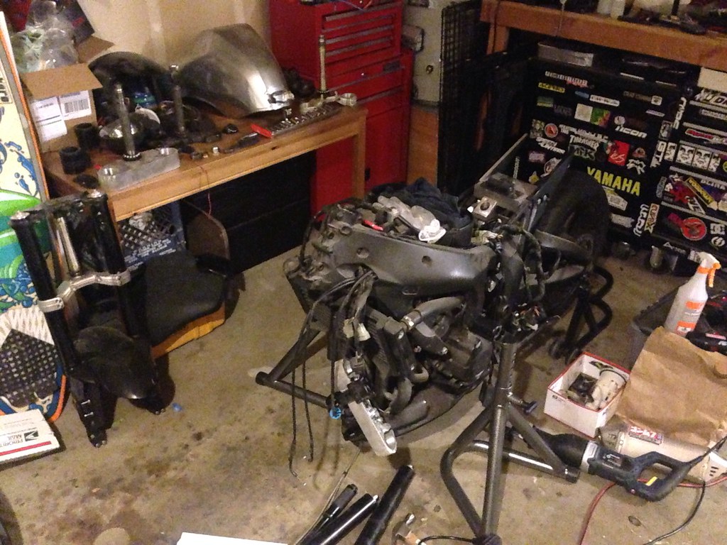

Hey guys- been a long time, since before the name change! Anyways, my fz project has been sitting in the garage for over a year now (long story)
I'm trying to put 2005 R6 inverted forks on, need some advice for pressing out the old fz6 steering stem from the lower triple. Does it press up through the top or down out the bottom? Same for the new one? (Up from the bottom?)

Always pressed down through the bottom of the triple. A good way to think about it; tightening the upper hardware is trying to pull the stem up through the lower triple clamp. The retaining ring on the FZ6 and machined base on the R6 are there to counteract this force.
Hope this helps!

From what I've read on other posts and by measuring my 2 steering stems, the r6 stem isn't long enough... but yes I will be converting to allballs too!

You can use the R6 stem, you have 2 options, 1: get a upper bearing crown and race for an R6, or 2: mill the upper portion of R6 stem to match the FZ6 stem, two years ago when I did the swap I milled the R6 stem,it costs more but you can put the FZ6 forks back in when you sell it, plus the R6 stem is alot lighter than the FZ's.
