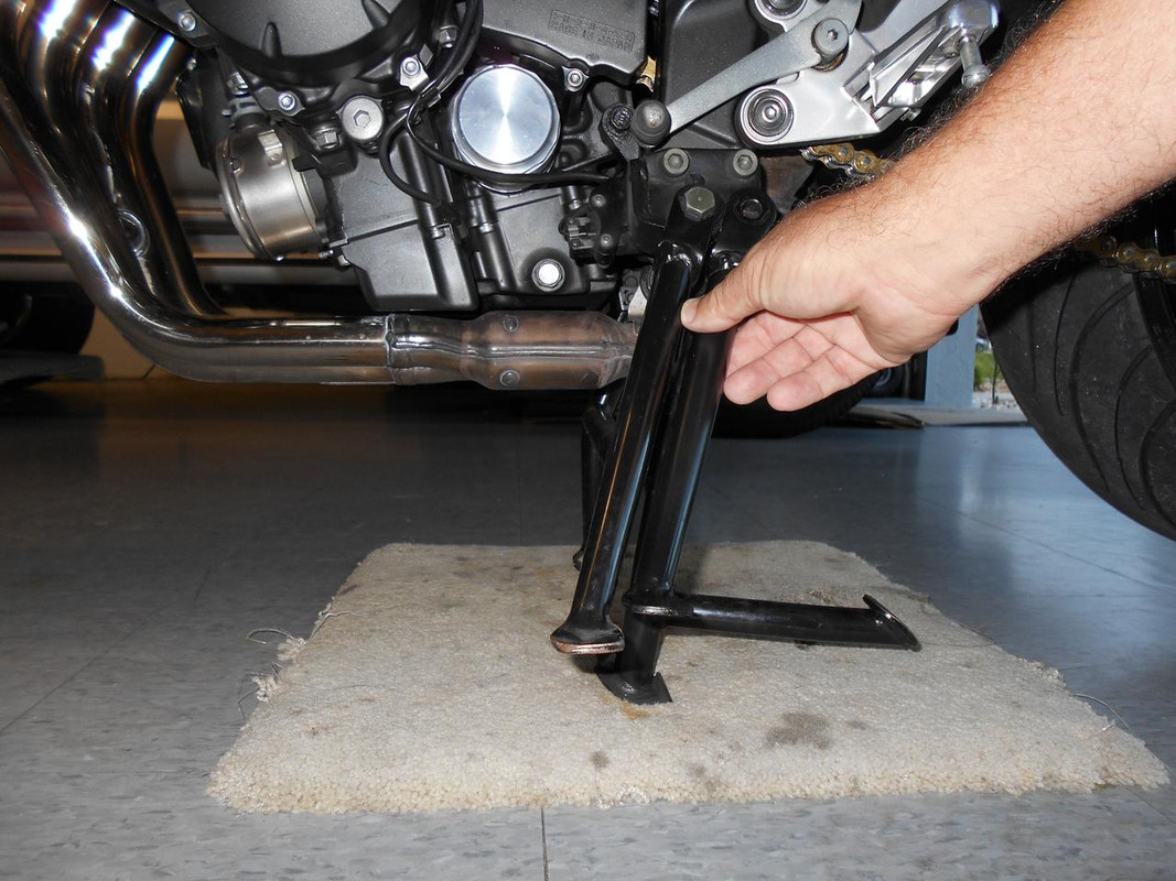

Keep in mind that when the bike suspension height is changed you might modify the side stand. This may have been done already. The fact that you have front end wobble is the 1st thing you want to solve before getting back on your bike.
Dropping the front of the bike even 1/8 inch will increase what is termed "turn in" Too much turn in could result in wobble but as Gary has listed, there are many things that can attribute to that anomaly.
