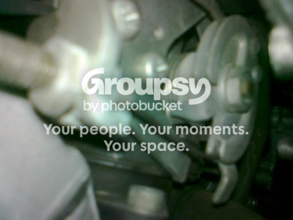

Reading the comments I see that the "throtthe weel" is different on my bike.
It looks the small piece is closer on mine that normal 98HP modells.
It's that mean I only need a 98HP model throtthe wheel?
'cause it looks on normal bikes the stopper is placed at the red point and on mine is at the blue point! Am I right? :eyebrow:

If you look at the first and second pic's on my post, #20, you can see the throttle closed and then fully opened literally up against the stop. The "wheel" has a tab that points inward and your picture shows a different cable holding/throttle stop as well...

Yes, it's different because I haven't found the exact technical drawing and part on the Net.
I'm trying to get somebody who is selling used parts and get a working used 98HP full mechanic. (marked with red on #6)
Or any other suggestion?

I found a FZ6 98HP.
Here is the difference:
98HP working:
It looks the wheel is what I need! :cheer:

This is one of the reasons europe is gay! Just kidding mates.... The wheel can not be purchased by itself. You will have to finf a used throttle assy. I would just grind the tab down and make my own stop. Hell of the alot cheaper easier solution. Slainte!

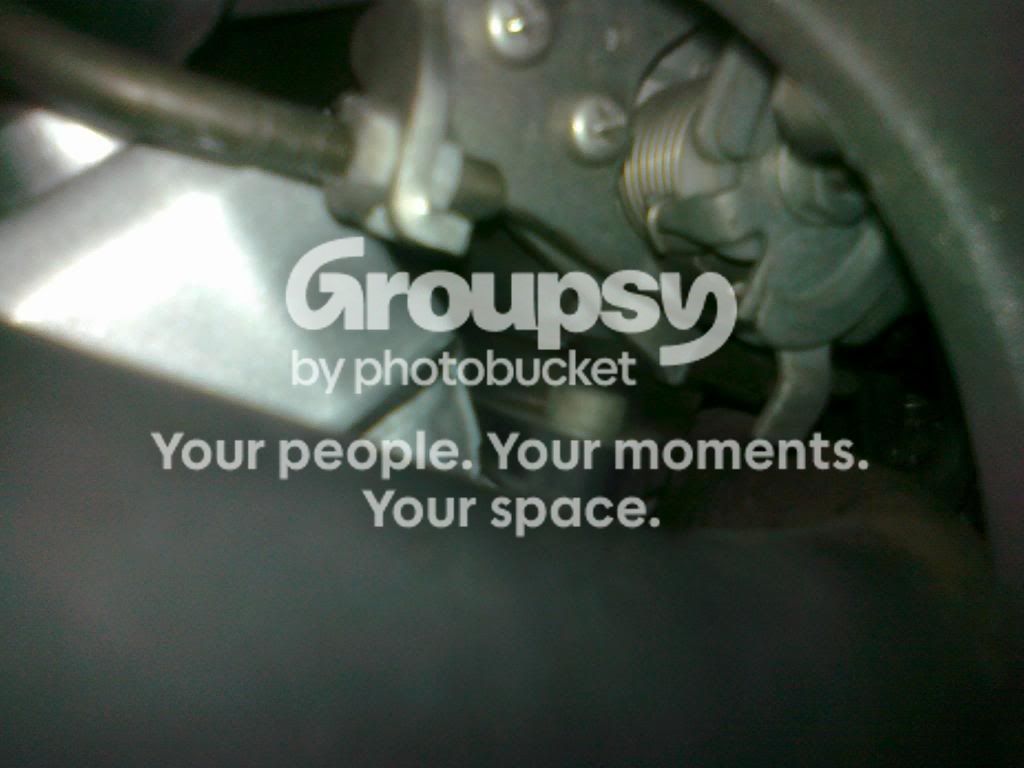

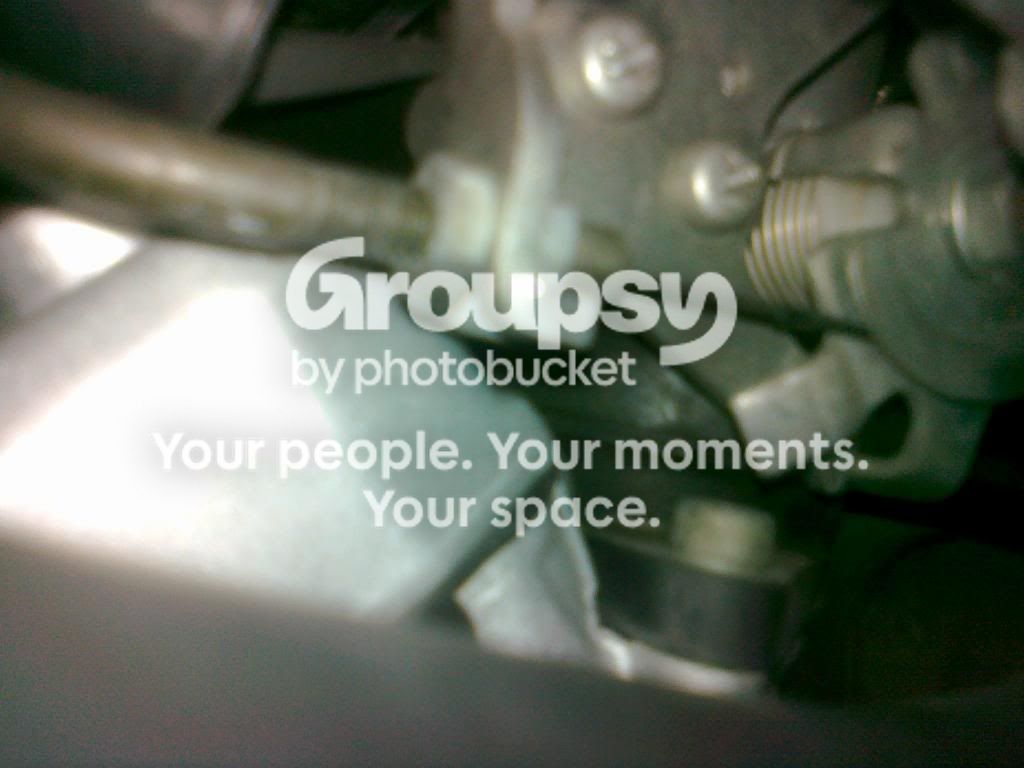

I just took some pictures of my throttle stop, open and closed. It does appear to move 90 degree's as it should for full opening.It has NOT been modified.
The last two pic's are from another poster's 78 HP version(different post).
Comparing pictures, it seems that not is the actual stop(that bolts to the TB) different, but the TB shaft end is somewhat different as well...
the last 2 pics are from my bike -- that is a 33kw (restricted) its factory restricted its not 78 bhp however that model comes with 2 stops (the 1st stop is restricted giving only 10mm from moving stop to plate ) so i dont know if its 78 or 98 i presume 78 ill have to take some new pics for this thread

Here are the throttle wheels. I successfully replaced to a 98HP one (boughts used parts for 25$. Installed with my friend in 2 hours (some help needed).
Thats all!
Any other modification needed?
(I heared something that is not enough?! :rolleyes: But I suppose this is just marketing bulls$t comes from reseller to go to him and pay 150$ for job)
12,516
1,157
Nice to know the secrets out.
You can bend the first tab, replace the plate or if your really anal, cut that tab off altogether.

but you changed the part to a 98hp "wheel" , so that statement makes no sense about keeping original parts and all u have to do is bend the stop back again to its original position if your selling it that would take another 30 seconds to do

true mate its just splitting hairs , was just suggesting a quicker and more logical alternative as he said himself it took 2 people 2 hours to put on a part that isnt original or necessary also cost him money - so it will take the same man power and time to put the old one back on when hes selling it , but each to there own he can do what he wants its only 2 hours :thumbup: id of took the 30 second approach which didnt cost 25 lids myself , which is what i did do :BLAA: its all good :iconbeer:
