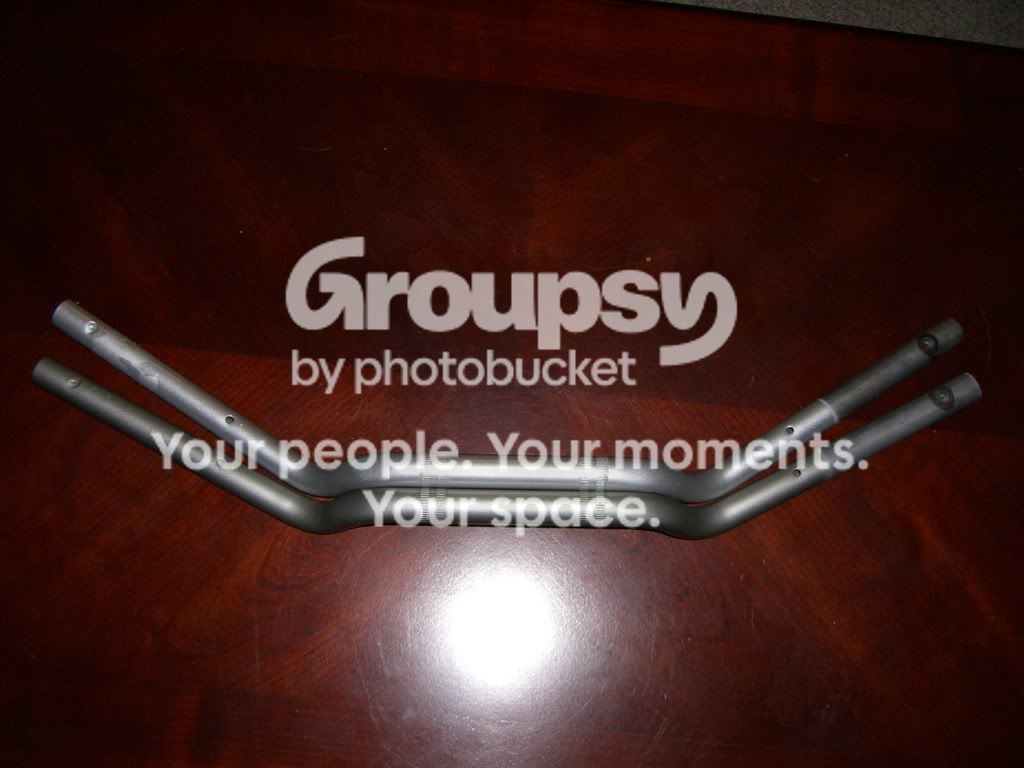

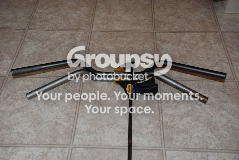

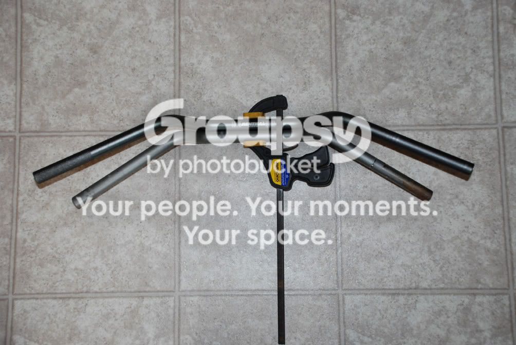

Desktop comparison. . . FZ1 PN 2D1-26111-01-00
And for whomever i stool the photo from, thanks! Others feel free to add to this. . .:thumbup:
FZ6 vs FZ6R
FZ6 vs Renthal 755
FZ6 vs FZ1
FZ1 Vs Renthal 755
Perhaps that will help you....

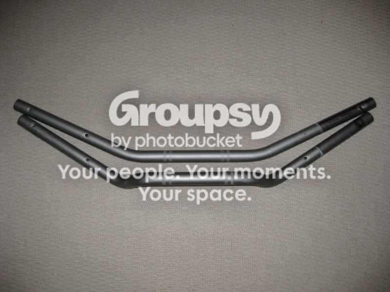

No good top down pictures but these are FZ1 bars... pictures from past before all the silver was powder coated black.
attachment.php
attachment.php

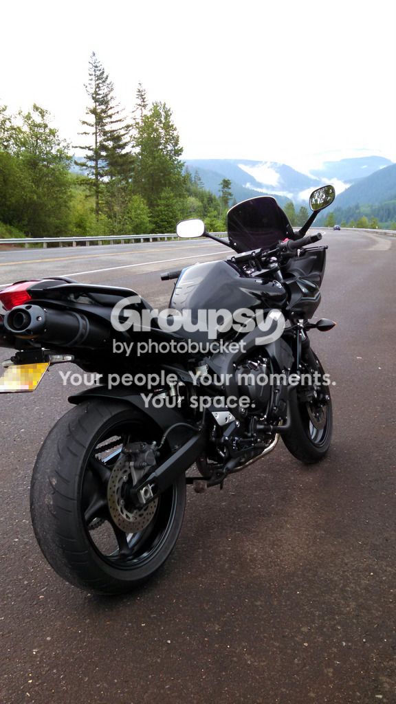

Comparison - FZ1 bars and yes, I got a ride in after being parked for 3mo! Gravel everywhere!
attachment.php
attachment.php
attachment.php
RainCityRider
New Member
Jun 5, 2016
98
Seattle
Wow thank you so much for all the shots! What made you choose the fz1 bars over the Renthals? How do you like your spider grips?
I definitely would like narrower, sporty bars. Think it would improve the whole experience. Maybe someone on the forum would like to trade...
Also, bar ends are the least of my splitting concerns:
Our intended use of these bikes may vary a bit, I'm out to play and seldom commute anymore. That said I find the bars forward but not uncomfortable. They definitely have more sweep than yours. I'm 5'10" 32" inseam so the bike fits me pretty well.
SpidiGrips, I like them. They come in different densities, colors and all that... that said because I picked a soft compound, they are wearing and will need replaced. Also when installing they are orientation specific. So depending on what you use to stick them the clock is running to get them in the proper position.
The Renthals had too much rise for my liking so I sold them. These seemed just right. New from yamaha are like $35 but you'd need the original top clamp or different risers as these bars smaller at the mount.
