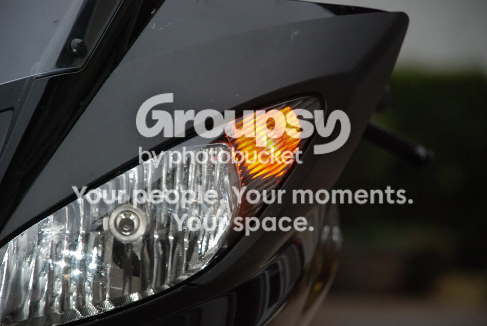

This is silly, but those empty holes in the cowl next to the light need some color! There will be more color and lights!

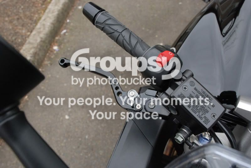

Something I did which made a HUGE difference in rider fatigue was to to rotate the brake and clutch so my forearm remains parallel when operating the levers. I'm 5'10" with 33" inseam so most of my height comes from the torso. With the the factory location of the levers it makes my wrists tilt up so I rotated the levers downwards.
People, if you find this it true of you, rotate the levers to align with your forearm so your wrist is not pitched upwards! But BE WARNED! The added mechanical advantage you get makes it real easy to pull that brake hard so be careful!!!

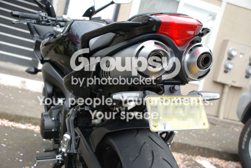

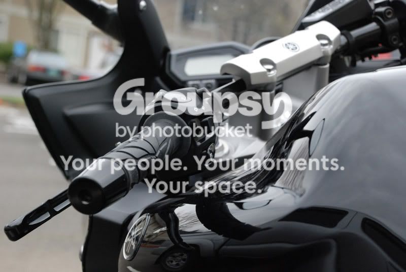

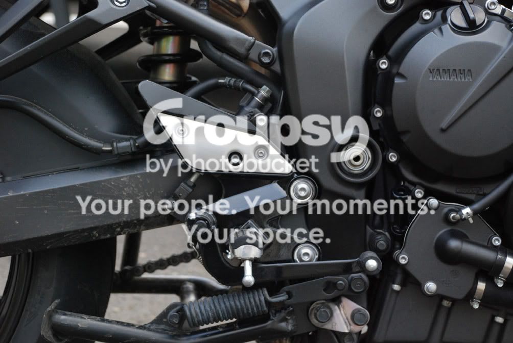

Nearly a year later and here we go:
R6 forks - check (but not here yet as of 2012-01-29)
New tires - check
Levers - check

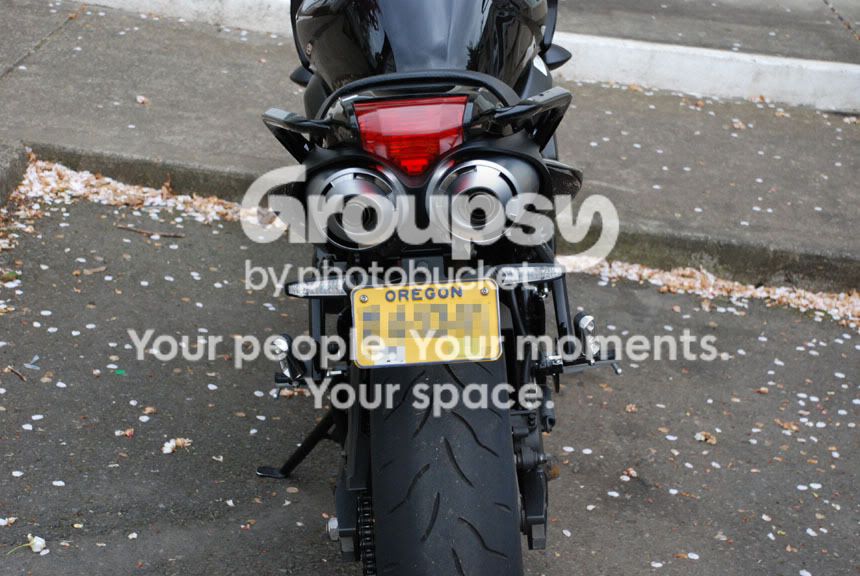

Tail Tidy - check
New Bars - check
Rear Blinkers - check
Pod Lights - check
headlight = Not modded yet, but will be during R6 fork install
Stickers = Gone

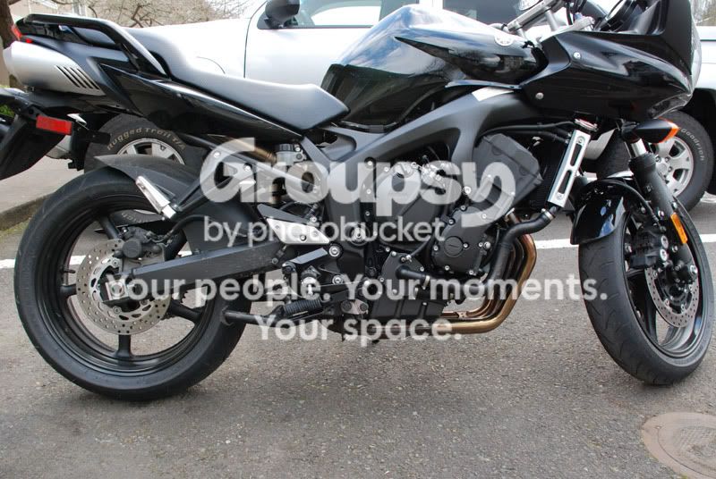

No Stickers // Photo from the past I found. . . :)
Left 2008 FZ6 and Right 2004 R6:
Tape to cut here
Fender is cut
Finished install
EDIT: 2012-02-23, The test drive after intalling them

Some changes I've made made and scattered about the forum since the R6 fork install. . . and the tires for Christmas!
I really like those grips, and the rear signals look extremely nice on the bike. Might have to get me a set of them. Great looking bike so far!
