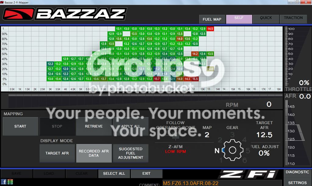

The base map with offsets
Recorded AFR
After collecting a few samples and reviewing notes, I make edits to the base map and create a new map. The goal being a 13.0:1 AFR above 20% throttle. AFR is lower below 20% throttle to absorb the load of take off. It is something to tinker with and so far the results have been good! Also, the higher AFR at low or near closed throttle are a result of the conditions, not the map. No load on the engine so its seeing a lean condition which is not a concern.
