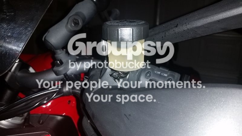

At the moment, I'm giving them an opportunity to get it right. They did mention about adding an extended warranty, but for how long and how much. What would be fair? They seem to be dragging their feet, saying they would get back to me, etc.but they have never called me back. I'm Losing my patience. Having a faulty fuel sensor in other words, inoperative fuel gauge is a minor inconvenience. It doesn't keep the bike from running. But the clutch will. Right now, I'm just going to take my bike to the local motorcycle shop near where I work and have them bleed and replace the fluid and at the same time, take a look at the slave cylinder and see if there is anything odd. Where did all that fluid go? Did it evaporate? I just purchased some DOT 4 brake fluid, hopefully that will be enough to get me there. Makes no sense to be making monthly payments on the bike, and not be able to ride it.

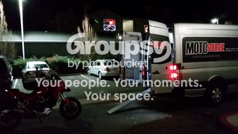

Bike is currently at a trusted independent local shop. The clutch was inoperative so they came by and picked it up. Flushing, purging and bleeding the new fluid is in order for starters. He's going to see if there are any leaks, the owner of the shop was curious where all the fluid went as well.

Bike is fixed, Fluid was dark, no replacement of parts needed. Just flush, purge and bleed new fluids. Engagement zone is where it should and it appears it's shifting a lot better, on the smoother side. Hey I can find neutral!
