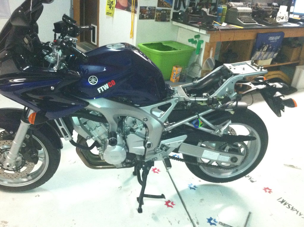

I really wanted some hard luggage, so I ordered up the Givi tail rack arms (FZ351), sidecase racks (PL351), and a pair of E21 cases. The arms and the sidecase racks will be coming in tomorrow. So I decided to tear down the tail section of the bike last night in preparation.

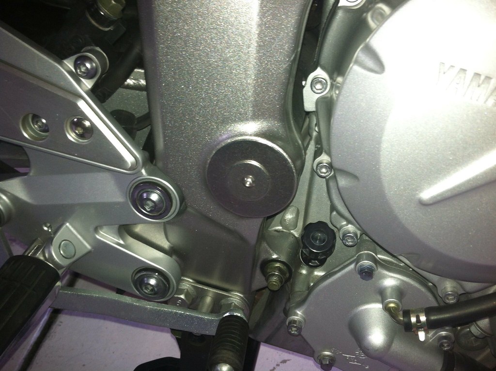

Also, while scanning the interwebs, I came across some frame caps that somebody was making and selling. My family owns a hardware store, so I figured I could duplicate them pretty reasonably. You be the judge:
I just used stainless allen bolts, fender washers, and some rubber well nuts. It cost around 5 dollars for the parts.

IMHO, I'd pass on the frame caps (although yours look good), only because its just another place or water to get into and cause problems..

After beginning to install the givi racks, I went back to the M4 exhaust. It was just much easier to mount up with the aftermarket exhaust.
I am running into a problem with the turn signals. The wiring is too short from where they were re-located and I didn't really want to cut and splice the stock signals. :(
I also buggered up the threads on one of the bolts, but I can always go get a new one from the hardware store.

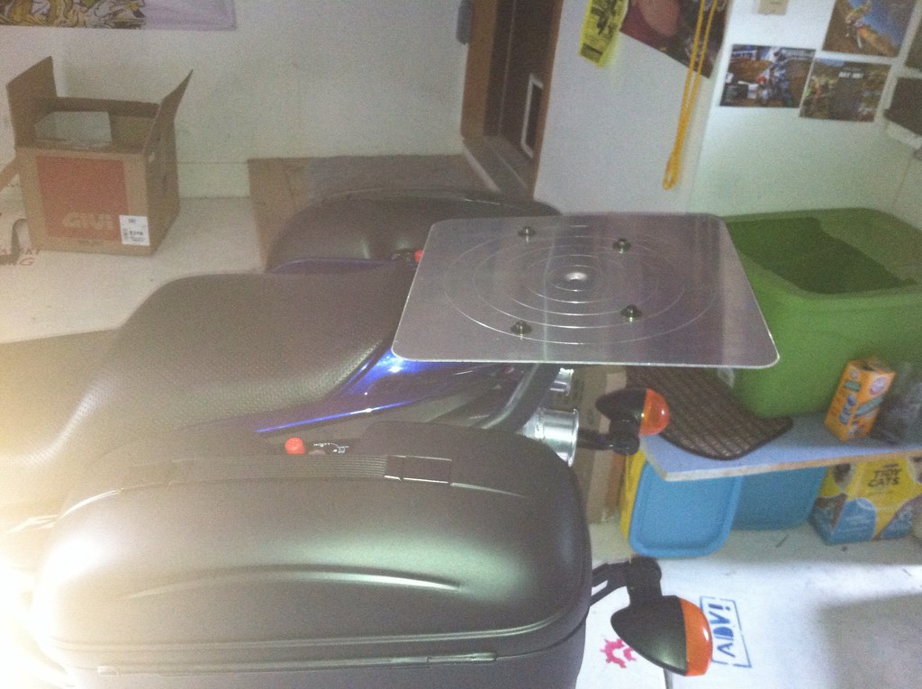

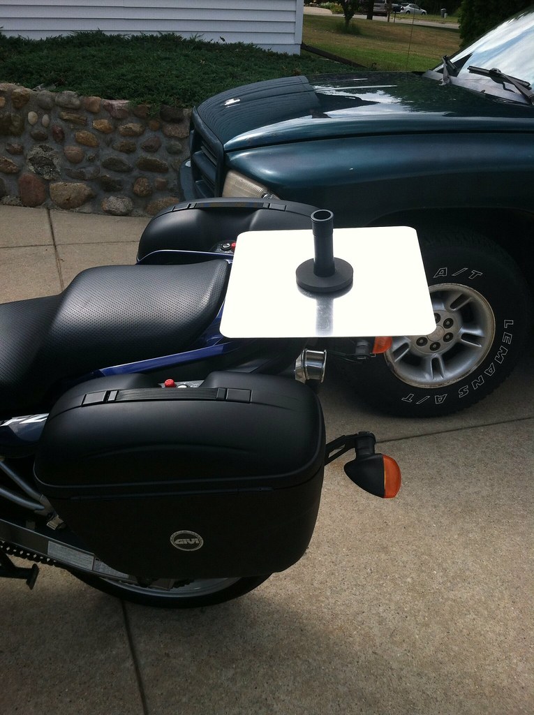

I recently set up my FZ6 with some Givi E21 sidecases. In order to do this, you must also have the monorack (150$) or a fit kit (30$). I wanted a top rack, but I didn't necessarily want to fit it with a Givi case, yet. I found out that I could just order the side arms for around 80$. This allows you to purchase a different style of top plate for different purposes. I figured in the meantime I would just bolt something to the top of the arms so that I could strap a dry bag to it. My original thought was a cutting board, but then I was at my local cheap tool shop and saw this:
It's some kind of drywall tool that's basically a flat piece of aluminum with a hole in the center for a handle. I measured and drilled the holes for the Givi arms and bolted it on with the (mostly supplied) givi hardware. I had to run to the hardware to pick up 4 washers and 4 m6 lock nuts.
That's it. It was 12 bucks and some change for the tool, 3 bucks and some change for the hardware ( I went stainless.)

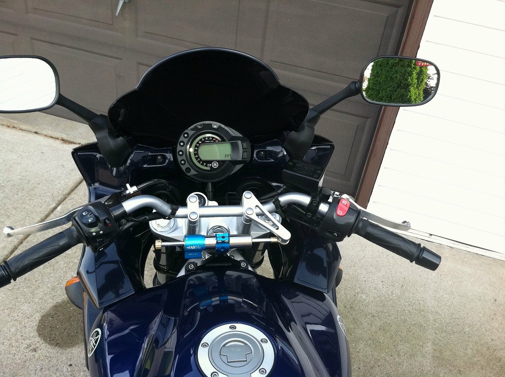

So that's not an added value. Also, the steering damper, like everyone said, is way unnecessary on this bike :eek:
