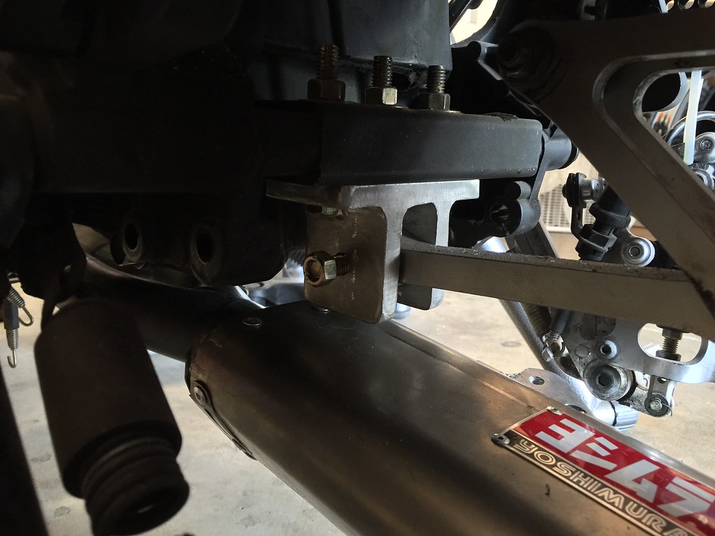

Did you add a mount for the OEM style link for that shock and S/A combo or mount the shock direct to S/A?
Hint im running an R1/R6 shock, but its revalved and has threaded adjuster. It worked out very well! Good control and nearly drop in - install. R1 shock install
it has the dogbones and everything from an 03-05 r6 (or all years r6s)

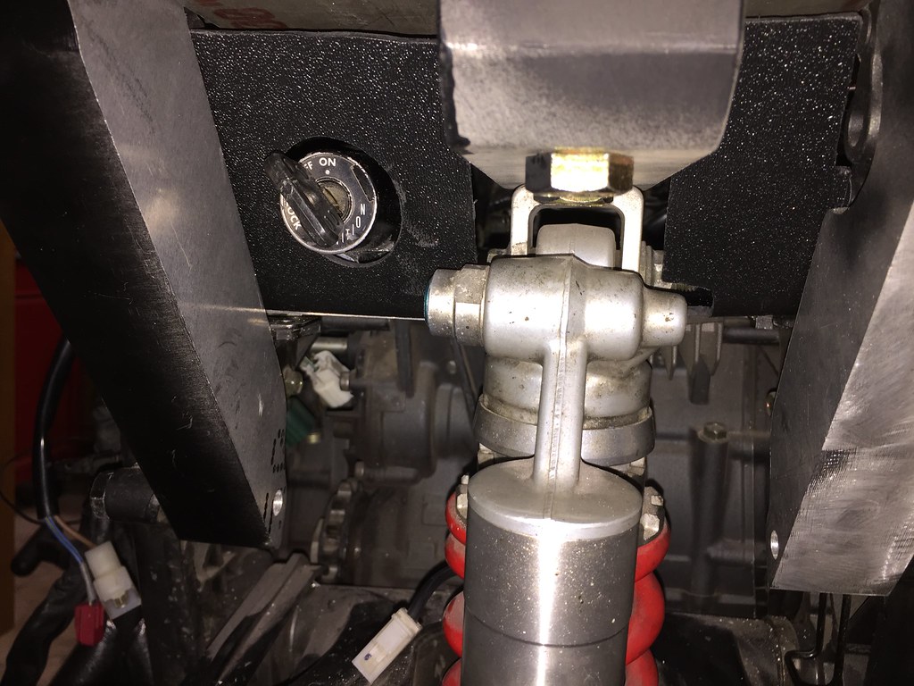

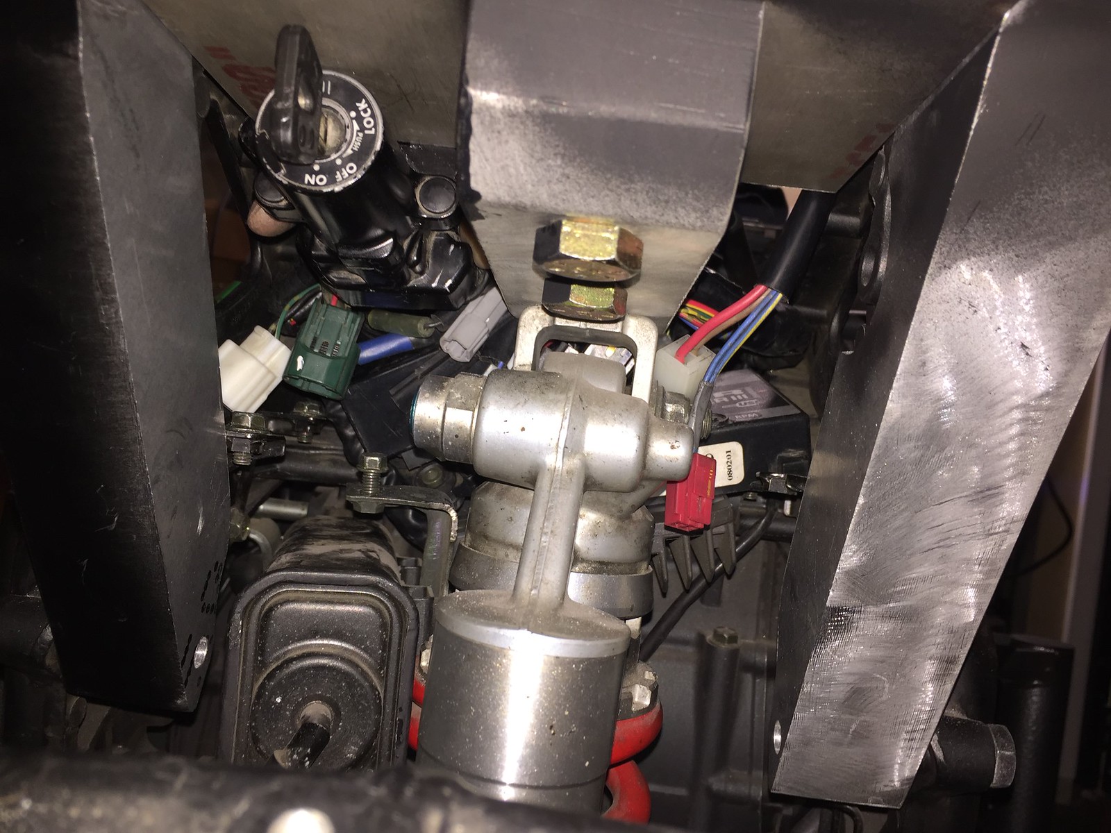

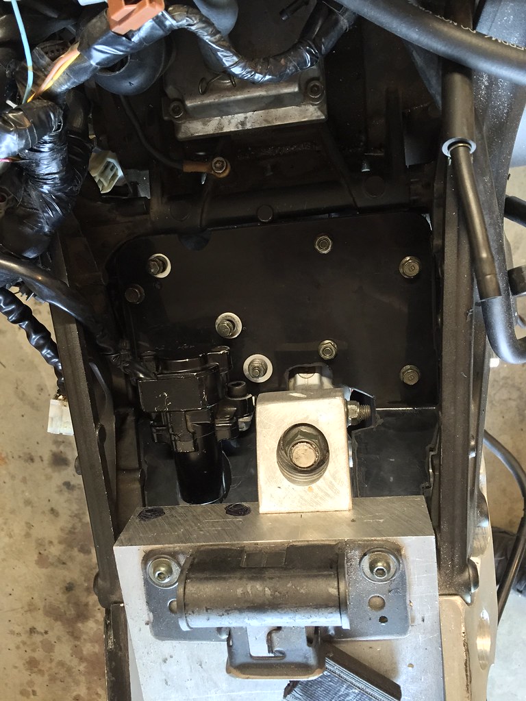

got a rough layout of all the electronics under the seat. gonna try to make a plate/bracket this weekend.. not set on rfid with all the bad things people have been saying, so i think i'm going to try and tuck the ignition under the seat too... it cant stick out the side like i planned because i'm worried about my leg hitting it
will be a pain in the ass to get to the key, but at least it looks good. again, this isn't my daily.

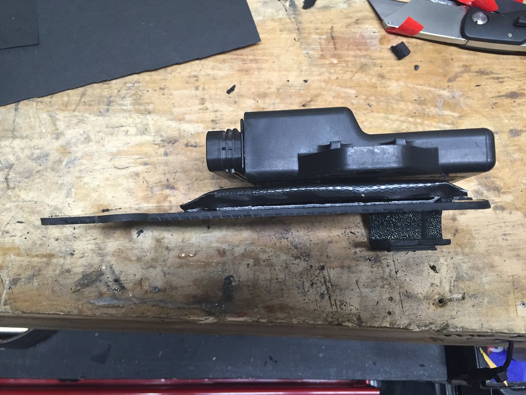

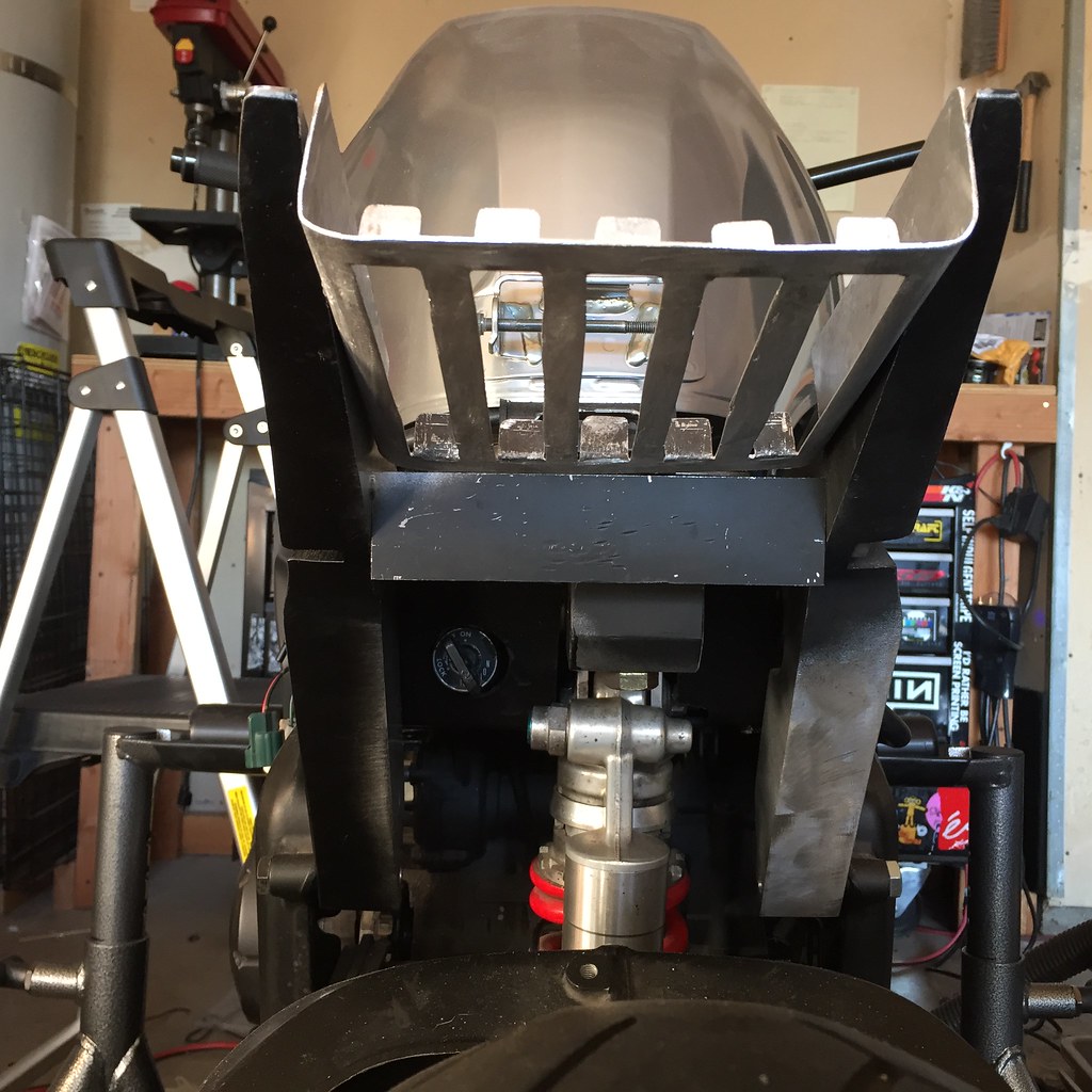

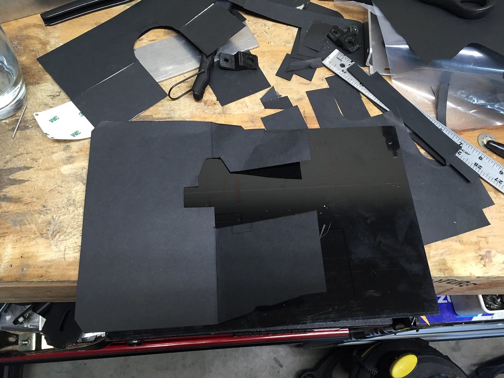

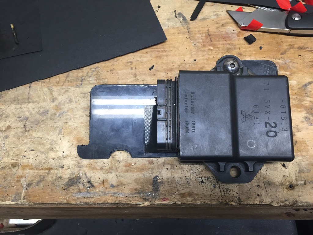

got the undertray pretty much done! ignition/breather box/rectifier are all mounted to it, its made from ABS not as stout as i'd like i might redo it in carbon but not sure if it really matters yet
no tray:
paper tray:
plastic tray (top):
plastic tray (rear):

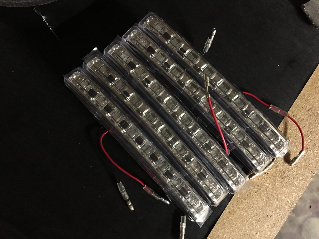

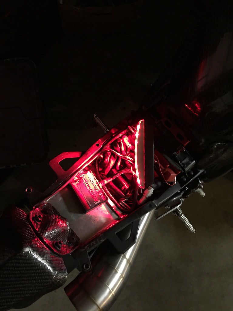

stoked. i found some lights and charged it to the game :( goddamn fighter money
tested one on my r1 they are plenty bright even from 90°
i'll have them roughly fitted by the end of the night even if i have to sleep in the garage. really dying to see, i guess i have to get a battery for this bike soon

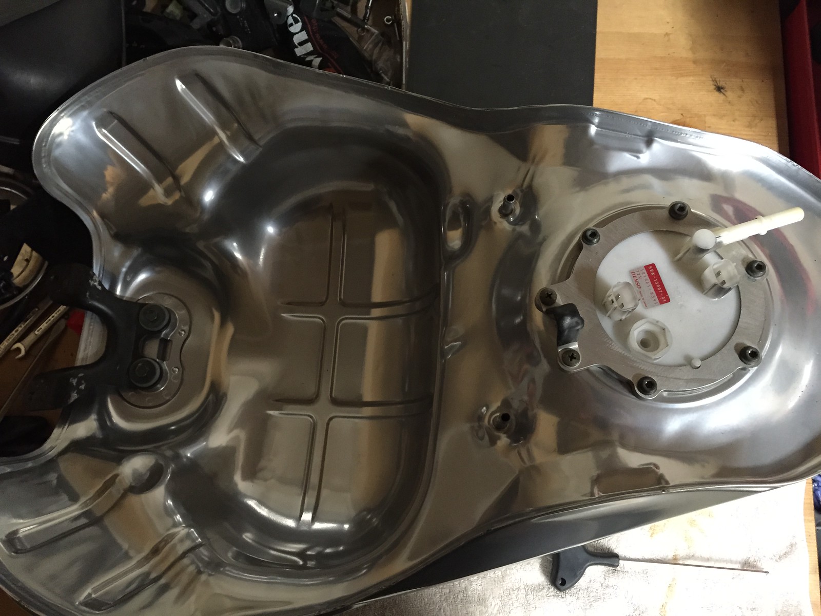

fuel pump mounted (dunno if its in the right direction tho :confused: LOL) matter of fact, i have no idea which hoses/lines go to anything anymore

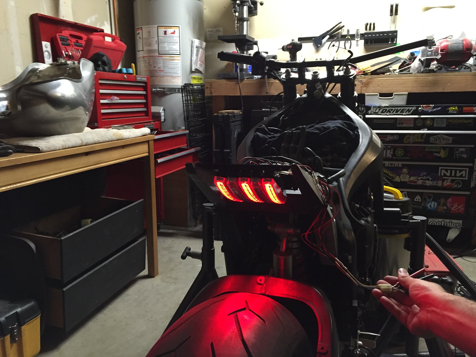

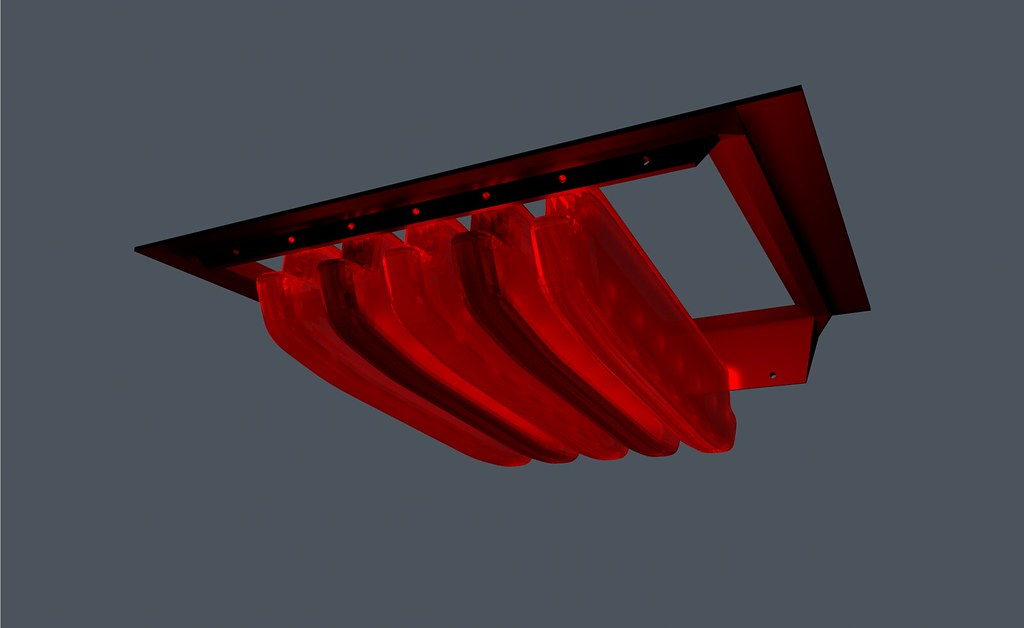

havent had much time to work on the bike, but today i had some time to cut out a metal bracket for the lights. hard to be too precise with the dremel/hand files so i might get a cnc piece cut once i get the design perfect. dunno yet, just trying to work on the perfect angle
I think you might be off one set of holes as the connectors should nearly be north / south. So, the fuel arm might be resting on the tank and not move its full swing. Not to mention the HP hose pointed into something....

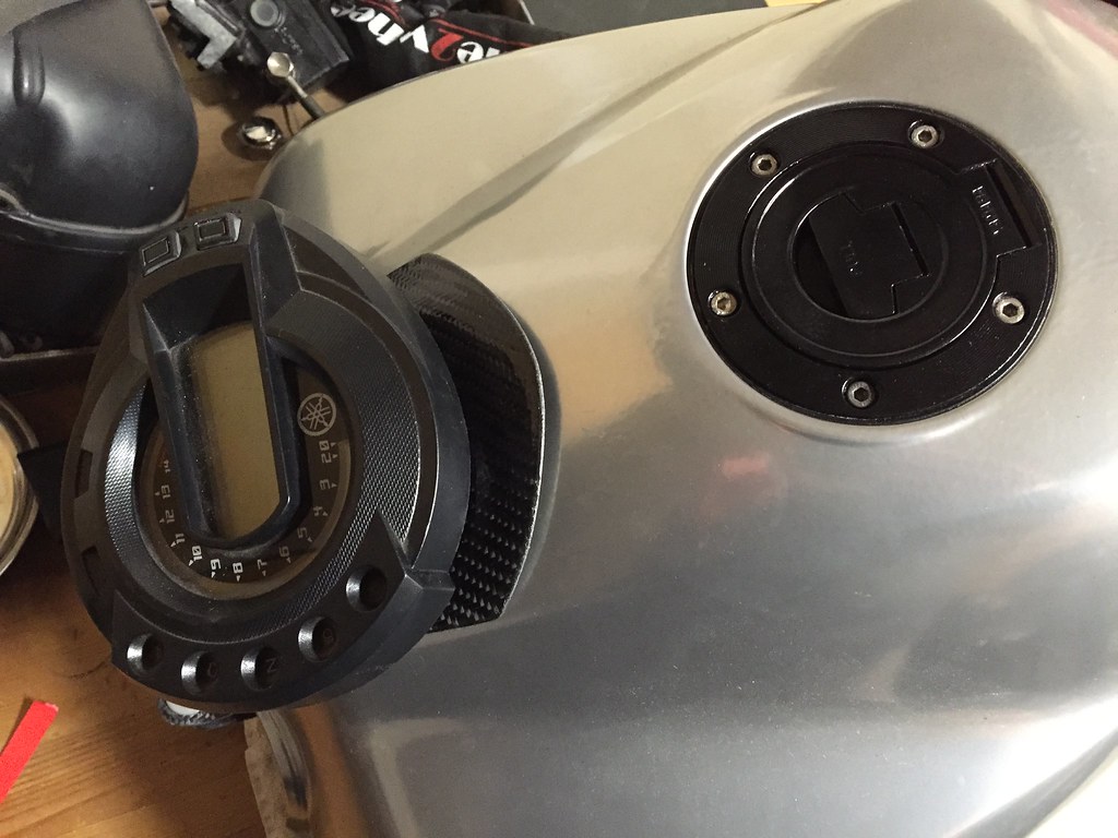

****ing around with some clay last night... not sure on anything
opt 1
opt 2
here is a photoshop of what it could look finished
You're gonna have a hard time getting away from the OEM as single data wire for many features:
Tach
SPEED
Distance
ECM /CEL
Oil Level
With you glass work you could take the back off an 07 - 09 and lay it down pretty flat making a new rear case??? Just a thought.
I have pictures of one I repaired somewhere...
Scan through here - one could remote mount the bulk of the data but its not worth the effort in my opinion. In this case, I repaired the PCBA as it had etched the traces off the board. Took the LCD panel off.
