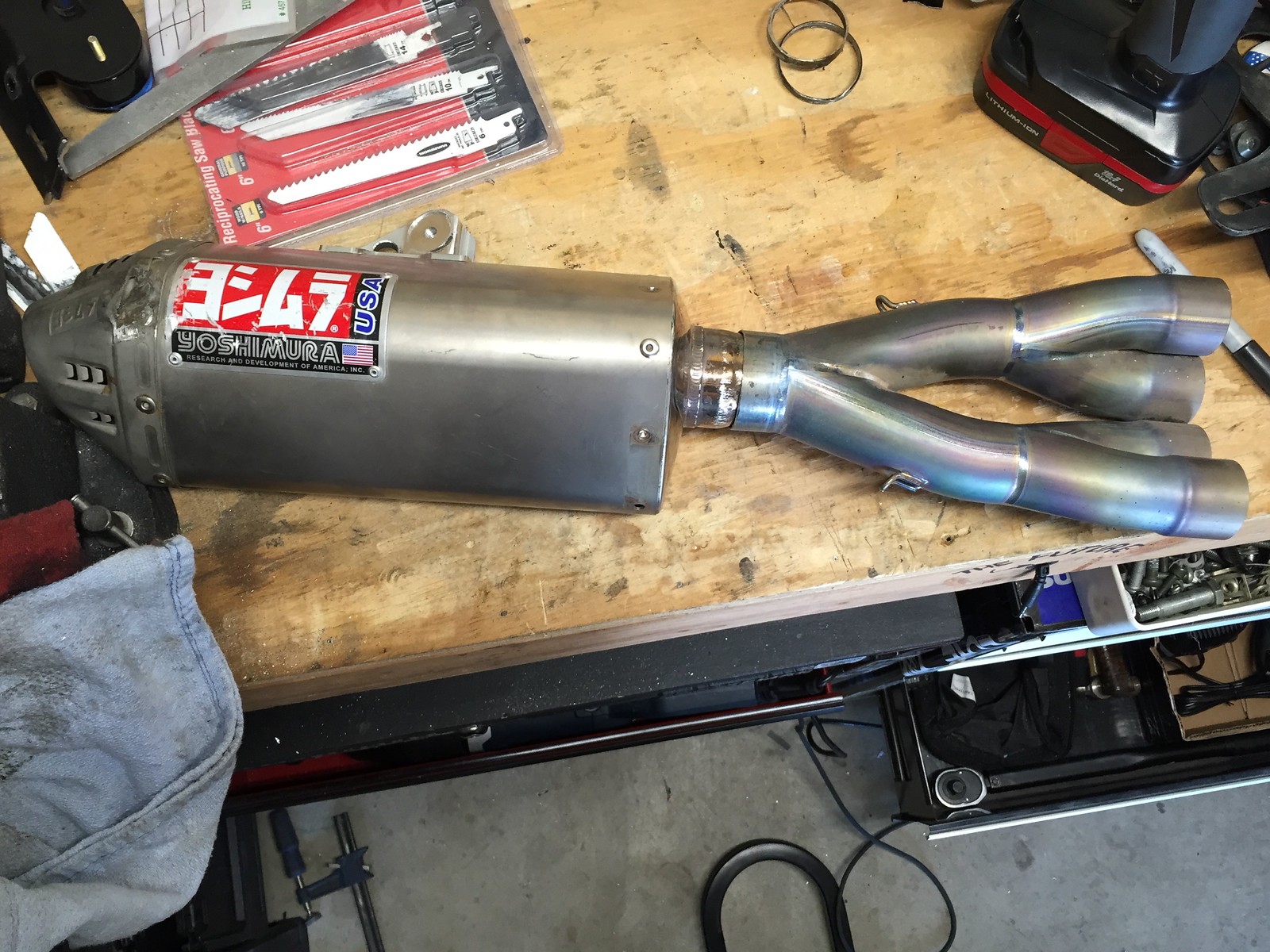

Q? That 4 into 1 collector, where did it come from and does it slip onto the OEM header, or is that an R6 header or ????
Any info about where it came from could be helpful. Tks
R6 titanium race headers.. i dont know the brand unfortunately :( they have some cool bends, i'll snap a pic next time i work on the fizzie
EDIT: pretty sure its an akrapovic now that I'm looking up pics

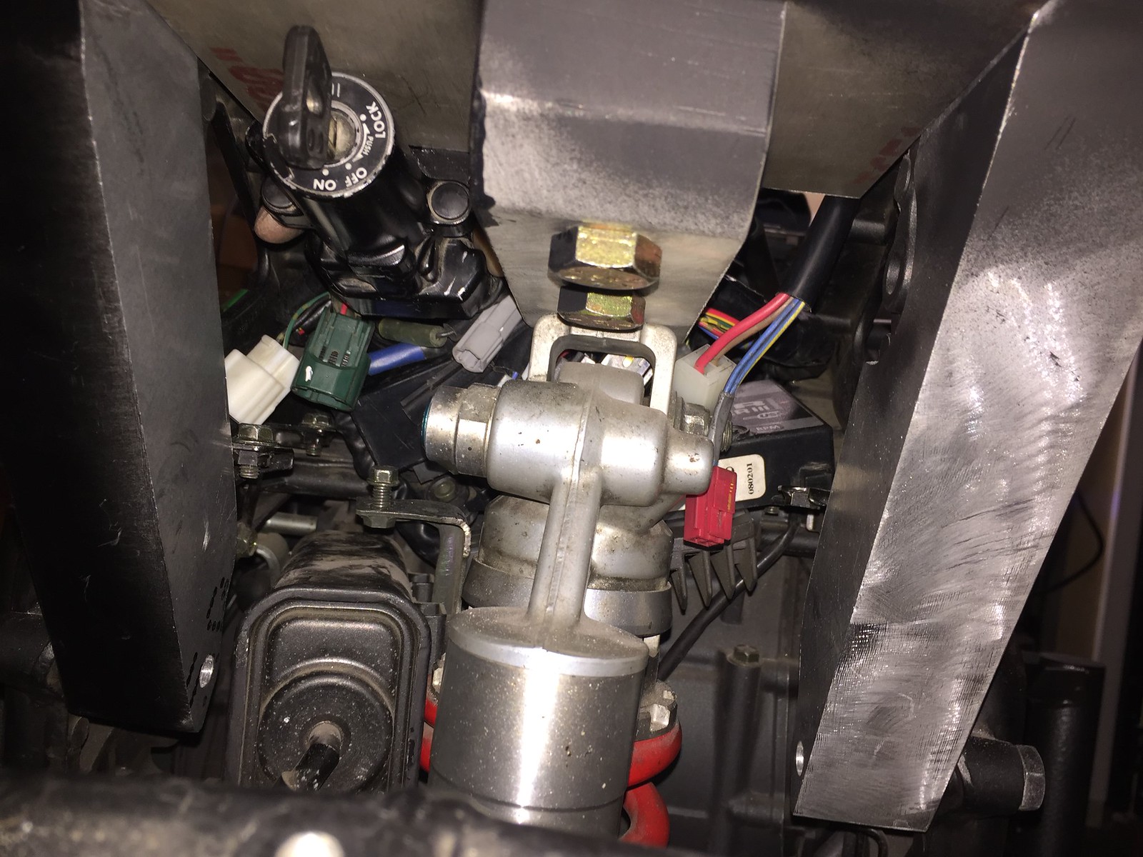

the fz6 steering stem is a little short, so i thin down the upper triple a bit.
45mm forstner
now the riser bolts just barely hit the frame clamp bolts :doh:
i can probably grind down the end of the bolts a little.. but its only at full lock (without the tank on). I think steering bump stops will solve this problem, and i had a cool idea for how to do them

Looks very nice.
I've never thought of grinding upper triple tree while doing R6R fork mod. Good idea. I can think of doing this later.
How deep did you grind it? It looks like 1-2mm, is it?

Looks very nice.
I've put some jb weld epoxy to the upper triple to make it more solid.
I took off about 1mm. If it was to do it again I would take it from the top, it wouldn't push the triple down towards the frame. But I was too lazy to take everything apart last night lol.
About the JB weld, do you think it actually does anything? My thoughts are no, but I'm no engineer... If it needed more strength (which I dont think it does) the proper way would be machine out some larger holes and weld in a solid sleeve. Overkill probably. Your triple looks good tho! I would ditch the ignition it seems so bulky up front

I rode it 10k km for 2 years without any grinding of the upper triple by the way. R6 triple tree's short stem has enough teeth. But grinding it a bit can make it more solid. Grinding it from top is another good idea.
I am not an engineer too, but i guess it can take care of horizantal forces that handlebar applies. Also handlebar clamp bolts washers had more space with the epoxy fill. (May be)
I agree, probably plenty of grip on the steering nut already... I mainly wanted it to look better, peace of mind :) I'm waiting for a new nut to arrive in the mail, but if I need to machine more metal out it will be from the top.
