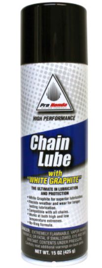

This chain lube is awesome, I really like it already over what I was using. Used a chain cleaner first, scrubbed the chain clean. It looked new. Applied to thorough coats of the Honda stuff and i've never seen a chain look so good. Did the same thing to my 250. Going to stock up :)
However the chain noise is still there, it not change at all. I'm just living with it for now.
