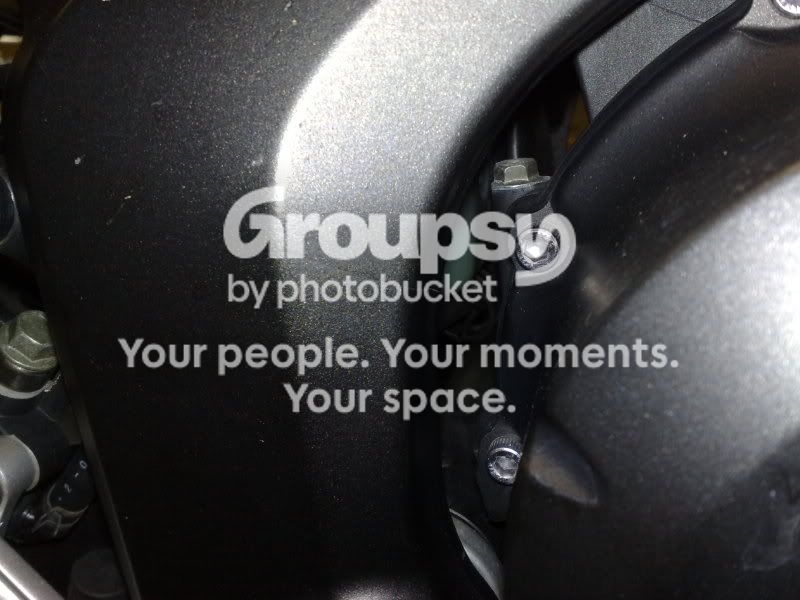

I fixed the pic in your second post, so guys can see a larger pic of where the crack is.
Good decision not to ride it, get it checked out, hate see the aftermath if it fell in half while riding.

Interesting....Right on the radius area...
Is the crack you have look really straight like the one in the picture?
I'd love to see the reverse side of that part..... that's such a straight line, it has to be following a rib/web/stringer. The casting process generally does not create high strength edges like stamping a part will. Lots of micro cracks and such to allow a stress fracture to form.
For sure, that part has an issue all the way through it.
