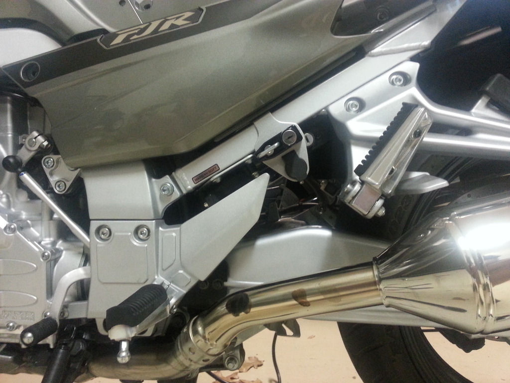

Yeah 2007 FJR1300. That is one of my main bikes, won't be selling that anytime soon.
I designed the left side helmet lock bracket / BMW outlet on my friends '07 way back in 2007.
