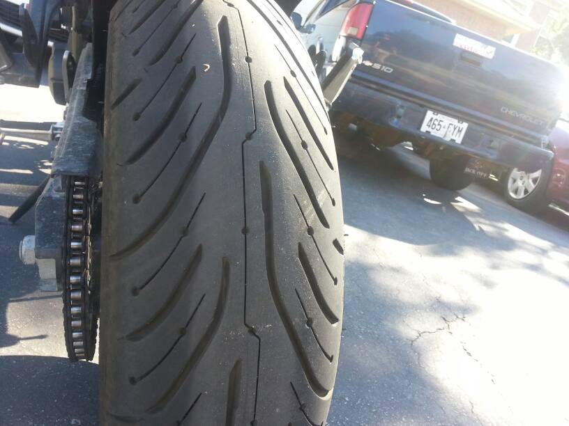

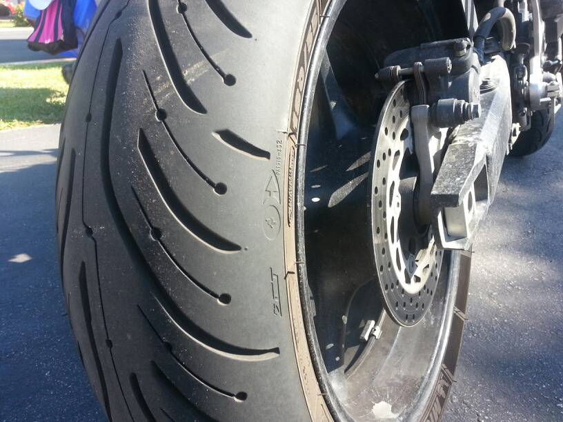

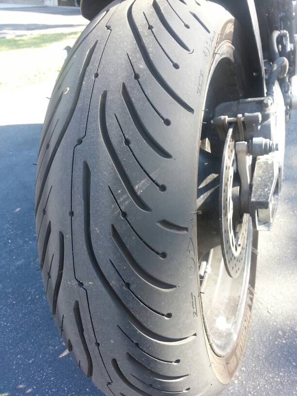

My pics are from Sunday mornings on the Putty Rd.
(https://www.google.com.au/maps/dir/...2,150.9344183,13z/data=!4m3!4m2!1m0!1m0?hl=en)
Couple of front and couple of rear (both sides).

My personal opinion: you're pushing it much too hard on the street (and I'm not talking about your chicken strips, which as I mentioned above are mostly meaningless).
Do you do track days? If not, you really should consider it!
You've got a bit of a cold tear going on there.. try dropping your pressure slightly.. 1-2 psi. See how it looks after next ride. When you get the pressure right, the tire will heal itself.. those *scales* will go away.
You also have a bit of a rebound issue, but if you've got a stock rear shock, there's not much you can do about it.
Be safe out there :thumbup:

Thanks for your comments, just to be clear, that's not what they normally look like!
Those pics are taken after several sighting laps (at normal road speeds) to check road condition etc.
The lap we do has no houses, side streets or any other cross roads.
Once we are comfortable with the conditions we start to up the pace.
2-3 laps pushing it and that's what they look like.
Those tires are dead now, will be getting new ones when bike back together.

Correction: that's a hot tear (sorry.. haven't had my coffee yet). I'll PM you.

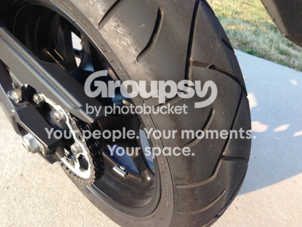

Here is mine.
