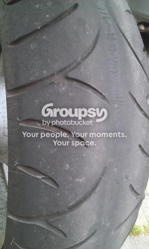

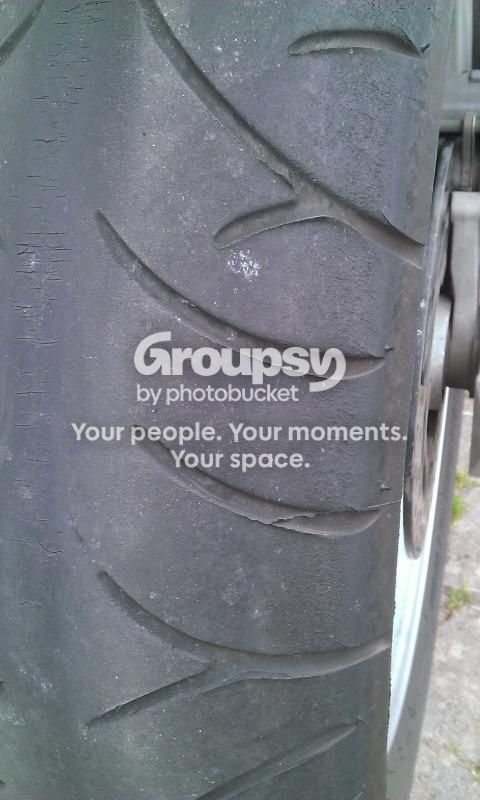

Well, as this thread was always going to be a willy measuring contest, here's my tinky winky:
In my defense, I've only been riding since march :rolleyes:
A couple pages back, FinalImpact posted a link about how tires are supposed to wear. It looks like you have a small issue in how your suspension is set up because you're getting some slight tearing on the trailing edge of the treads.
See here: Race Track Motorcycle Tyre Wear Guide - Types and Causes

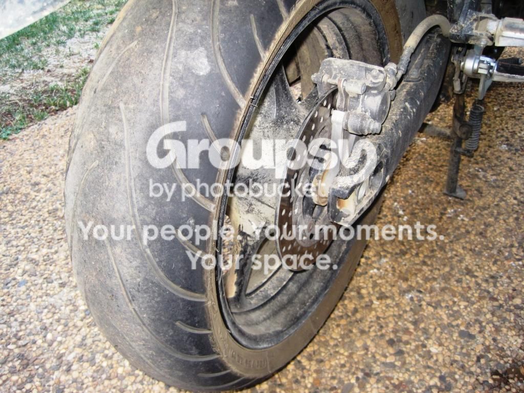

This was after taking my bike to Arkansas for the twisties last year. It was new to me and I had only rode it for about 2 weeks prior to the trip. I plan on not having any when I come back from the trip this year. I hope some of you guys will join us! :rockon:

+1. Unfortunately, there isn't a whole lot you can do with the stock rear shock, as this appears to be a rebound issue, but at the very least, make sure your pressure is where it should be and set your sag as well as you can (the pre-load adjuster is quite effective on FZ6.. not that it's a substitute for correct spring weight).
Oh and.. I know you know this, but it's time for new tire! :thumbup:

I'm glad I now know that you know that I know this :) PR3's going on as we speak.
What I couldn't make out from Finalimpact's link (thanks Chancecoats, I'd missed it), is whether I need to have the back softer or harder. I have it set on 5 now, 4 when the tyre was new, anything lower feels soggy. I'll admit to riding with some enthusiasm, and most of our roads are twisties, but at 90kg (in gear) I'm hardly heavy. I'm meticulous about tyre pressures, always run factory spec.
Having spent years modifying my cars to more or less extent I was really hoping not to have to mess about with the bike!

The rear adjustment doesn't control hardness, it controls preload, which in a nutshell is ride height... "Hardness" is controlled by damping, which cannot be altered on the stock shock.
At your weight i would think that 5 would be the correct setting, but the only way to be sure of it is to spend a few minutes with a measuring tape and measure your suspension travel.
I weigh 80kg without gear, and the stock shock on 5 gave me:
Rear preload on 5
Rear static sag: 7mm
Rear rider sag: 30mm
Which is as close to perfect as i could get it...
Here is are good articles on it:
Motorcycle Suspension Set-up
Peter Verdone Designs - Motorcycle Springs
And a great video showing you how to set sag:
https://www.youtube.com/watch?v=mK3flKxf41U
https://www.youtube.com/watch?v=Ikjw4IheeF4

Yup! Exactly what Carlos said. FZ6 is very easy to measure, since it has a center stand (well.. the faired version, at least). On center stand, you can get the fully extended axle to tail distance. Then mesaure same distance with bike resting on 2 wheels (helps to have someone support the bike while you do this). You want 5-10mm static sag. Now measure the same distance wearing full gear sitting on the bike (obviously need a helper for this). Close to 30mm would be good.
But to simplify it, at your weight, 5 is very likely the right pre-load number. It's fine for street riding, but when pushed hard, the tire wear will quickly show that stock suspension damping is not ideal.

Ah, okay that makes it a bit clearer, at £300/set I can't afford to be using a set every 4 1/2 months/ 6.5k miles! Will check sag, see how this set start wearing and report back. Thanks all

Also that suspension is going to compress more in the turn as there is added pressure.
I had mine cranked at the way up to 7 and my stoutness showed no love. Still as an overall bike you can't beat the FZ6 for fun! :rockon:
